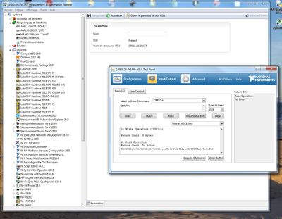

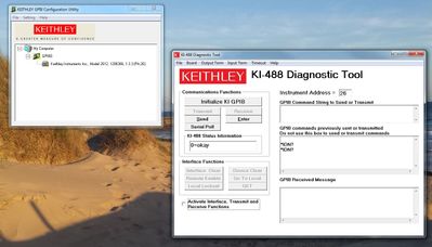

I passed all the communications tests with Keithley Diagnistics Tools, NI MAX... (see pictures below).

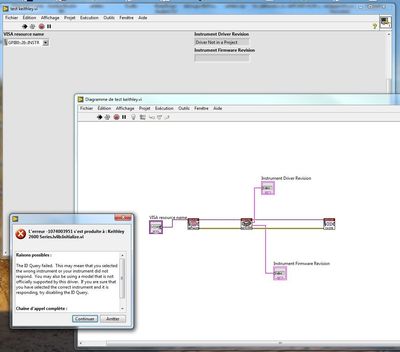

But I failed to drive a query with using Labview.
May someone help me please to solve such an issue? I do not know what is wrong? Where is the issue?

I found a functional path if I put "False" the ID Query and Reset in the Initialize VI.
Does it seem correct to you?

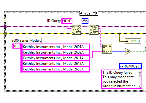

Is this a new or an old Keithley 2612?  The ID query just reads a string from the instrument in response to the *IDN? command and compares it to a list of expected strings.  If the response is in the list then it must be the right instrument.  See image below.
For some reason your SMU isn't returning a string the Initialize.vi recognizes as belonging to a K2612.  Perhaps its because its a really new instrument and the K2612A should be a K2612B or K2612C??  Or its a really old instrument and they firmware omitted the "A".  You could easily debug the ID Query by watching the returned string with Execution debugging on and then making your own Initialize.vi to accomodate the string your instrument is returning.
