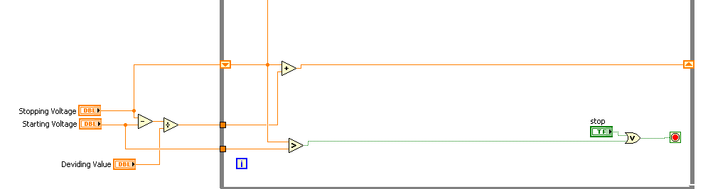

Your format string is set for normal display. In order to send the \r\n, you need to set it for '\' Codes Display. right click on it and change it.
Your last VI does not have the Read? command.
You are converting the reading to an integer. You want to convert to a float. Don't strip the exponent.
Your VI has some code that is very confusing and almost certainly unnecessary. All of the stuff with the divide and insert into array makes no sense. If the dividing value is supposed to represent number of steps, subtract the start voltage from the stop voltage and divide by number of steps. Use a shift register. Something like the image below.

I just learned how to use shift registers.
Thanks to you, I made it much easiar to understand now.
I used the dividing voltage as an incrementer to the starting voltage (that's what i wanted).
But the error -110:command header error still persists, even after changing both constant strings to \code display.

You changed to '\' Code Display but did not fix the format string! Notice the \\r and \\n? And if the first command requires a \r\n, then the Read command requires it as well.
And NO, do not eliminate the code after the E and NO, do not convert to an integer. Why would you want to drop the exponent and why would you want to eliminate all decimal places. Read the help for the function you are using or get an understanding of the differences between an integer and a floating point number. You are converting 00.2317 to 0! Use a Scan From String with a %f format string and leave the string alone.
You also want to wire a False constant to the reset input of the Build XY Graph. Otherwise, you won't see anything except a single point.

Here’s a picture of the block diagram of the last VI that ADDS posted. Try to follow along what ADDS and Dennis were discussing. I’m not sure how similar the command set for the 6517 and the 6485 are, but this should give you a good starting point. If you have more questions it may be better to create a new forum post. Good luck!
Edit: forgot the pic!
