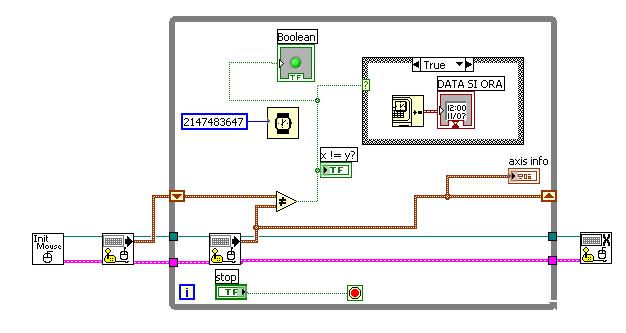

Message 9 of 18
(6,680 Views)
This is how mine looks like... And it just displays the moment when I press START! After that it just stands still (both the time and the axis panels)!!! I have LabView 8.0...I know it shouldn't matter but...
What did I do wrong?
