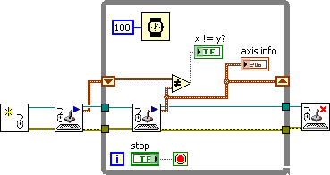

As long as the mouse is recognized by windows, you can use the functions on the Connectivity>Input Device palette. With Acquire Input Device in a loop, you just have to look for a change in the axis info.

A while loop is sufficient. After taking the tutorials, you should know what a shift register is and how to use the comparison functions (i.e. Not Equal).

First, you do not have a schematic. You have either a front panel or block diagram. A schematic is for electronic symbols.
If you want to know when it changed, then a simple way is to wire a case structure to the Boolean and place a Get Date/Time function in there. If you want to know the current position, that is being displayed in the axis info indicator. If you want to display the delta, then subtract the previous position from the present position. Just wire both clusters up to the subtract function. You could also put a write to a table of the delta information/time inside the case structure. A table is just a 2D string array so you would have to convert the cluster elements to an array with Cluster to Array and then convert to strings, Another shift register with a Build Array would handle the writing to the table.
Try writing something and see how far you get.

Yes. If you had done the 'case thing' correctly, you would see that. Post what you've written.
Message 9 of 18
(6,748 Views)
This is how mine looks like... And it just displays the moment when I press START! After that it just stands still (both the time and the axis panels)!!! I have LabView 8.0...I know it shouldn't matter but...
What did I do wrong?
