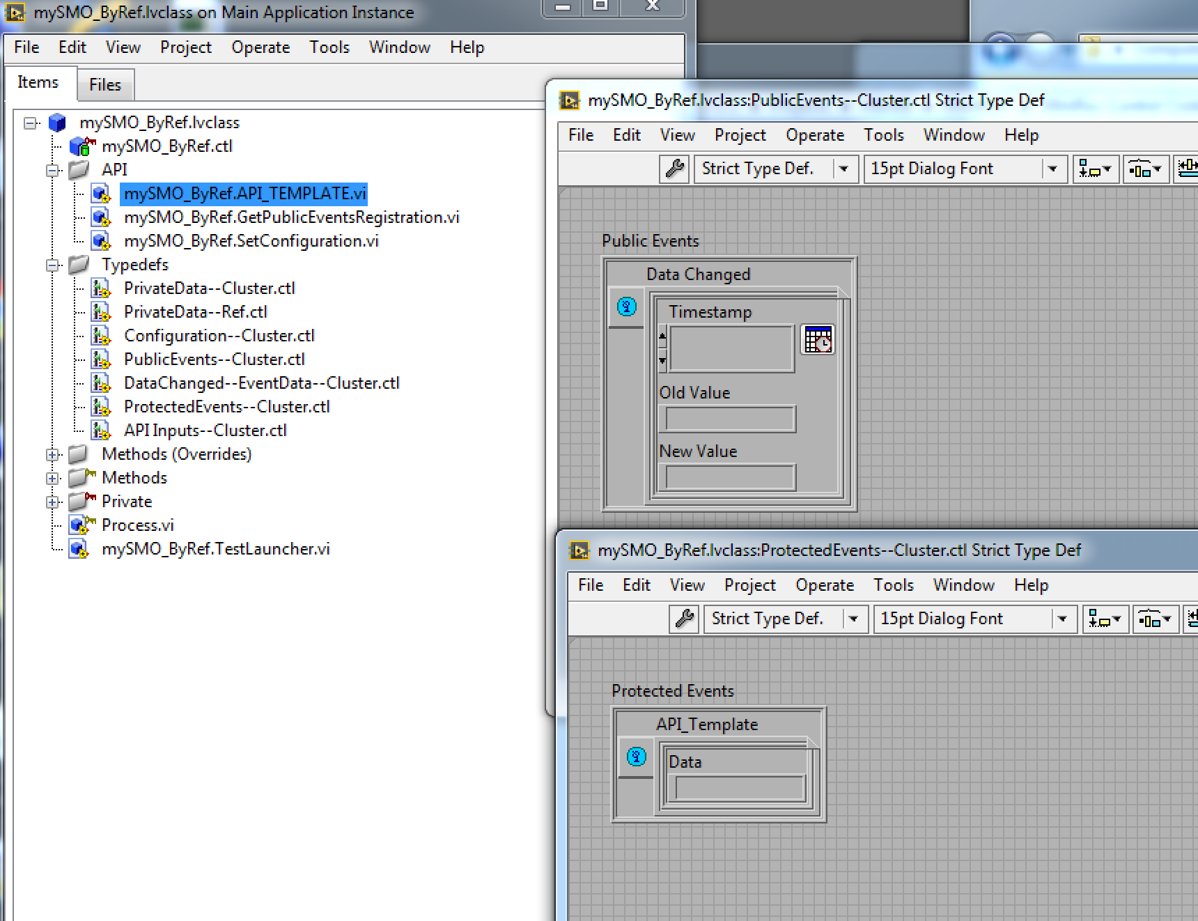

Thanks for the question,
If you look in the provided examples, we use User Events to communicate bewtween SMOs. Also, the ByRef examples have an example event that you can look at. The API_TEMPLATE method shows you how to communicate into an SMO. The Public Events are how the SMO communicates with the outside (any other SMO just needs to register for the public events of the first SMO).
Please let me know if you have any other question
