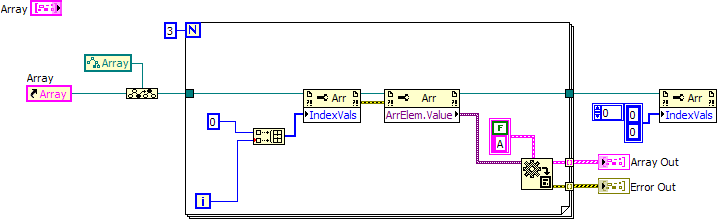

The second operation that doesn't seem to be working is trying to access existing array elements.  If I set the IndexVals property then access the value what I get isn't the actual contents of the indexed element.  The result I see after trying to read is an array of 3 elements containing a boolean false and empty string.  See the snippet below (same issue with the Array 3 terminal, should really be a reference to Array 2).
(Seems like this should work, since writing to an array does work this way, set the indicies, then the value and the specified element updates.)
(The reason the loop count is 3 is I thought this might provide a work around for the first issue by just indexing until hitting the end of the data.  But there's no indication that you've gone past the defined data, you just get back the default value.)

To get individual elements take the output of your value property and index it as you would any array. Or am I not understanding your intent? The index property changes the indices on the array control for display purposes and are not the index of a specific element.

I don't have a constant on the block diagram that's getting changed when I create the snippet.  Here's what the original code looks like:
Since the original control gets copied in the snippet, I don't see why it has to convert the reference to a new control.
I can't use the property node to access the array data and index its return to access the individual values because I don't necessarily know the number of indicies.  The code above doesn't really do what I need, it was just a test to see if I could read an element by specifying the indicies.  When I run it, I get the following result:
You can see that the output does not contain any of the input array values.  So specifying the indicies doesn't affect reading the value.  (As I originally mentioned, if you specify the indicies and set a value, it sets the element you indexed, but this doesn't seem to hold true for reading the value.)
