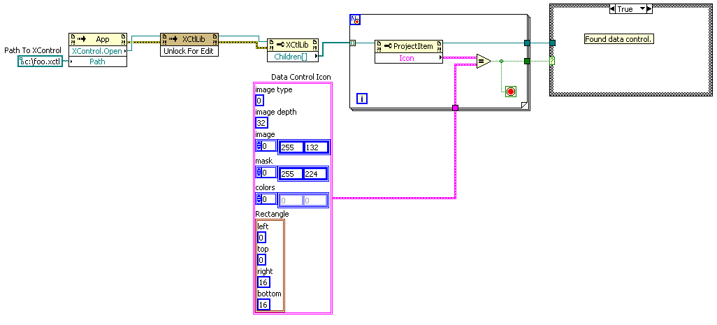

After a lot of searching, this is the only mechanism that I could find:
I built that icon constant by getting the icon for a known Data control once and then making it into a constant.
There may be a better way, but I couldn't find it.

Thanks for the reply.  At least now I know that I wasn't just overlooking anything in my search.
I'm currently "getting around" the problem by assuming the first reference in the Children Array is the Data, the second the State, the third the Facade and the fourth the Init VI.
This also happens to be the order in the project explorer but I don't know if that order is forced or whether it just happens to work for my XControl.
