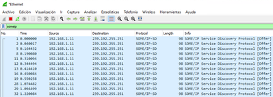

I'm running Client_Event_Serialized_Payload but traffic is in loopback adapter instead of Ethernet Adapter (server is offering services there).
What can I do?
Thanks in advance.
Message 17 of 23
(9,852 Views)
Just to confirm, does your C:\etc\vsomeip.json file specify a unicast address that matches the IP address of the interface you are trying to use (as documented in CONFIGURATION_FILE.txt)? After changing this value, you may need to restart your system.
Out of curiosity, how many Ethernet adapters are in your system?
Message 18 of 23
(9,783 Views)
There are two Ethernet adapters, which is in all devices. The IP address and netmask for the Ethernet adapter in use is set manually and written in vsomeip.json.
Anyway, I have disabled the ethernet adapter that I don't use and it doesn't work either. It only sends [find] requests through loopback.
