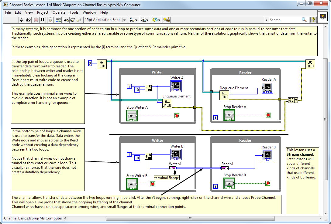

It's been a while since I updated this thread. We took a look at Vincent's comments and some other feedback we got elsewhere. Here's where we've ended up... this is a screenshot of one of the new shipping examples. You can see the small flanges sticking out from the nodes. We decided against going into the heart of the node in favor of a different shaped outside of the terminal.
Message 16 of 40
(3,627 Views)
Excellent, I love it ! I think this makes it quite clear it's not a standard wire obeying the good old dataflow paradigm - no more protests about breaking it I hope...
And now I can pretend I'm a real plumber while wiring a diagram - oh, and if your code starts to misbehave after a couple of years, first check you don't have any leak around that pipe flange, it might be time to change the seal
Message 17 of 40
(3,627 Views)
Is it possible to get a legible screenshot of "one of the new shipping examples"?  I have no idea what I am looking at.
Message 18 of 40
(3,627 Views)
Click on the screen shot and it should open in full resolution.  It does move off to the side so you need a wide monitor to see it.
