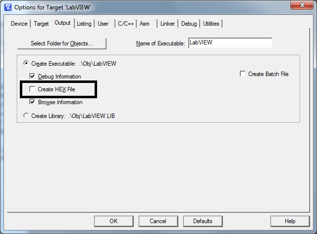

my reply was on the topic title: How to use USB interface with LabVIEW Embedded for ARM.
but for the mcb2400 you could build the normal application, and in uVision selecting in the build options to create a hex file.
with tools op NXP (flash magic), you can program the device.
Wouter.
"LabVIEW for ARM guru and bug destroyer"
Message 8 of 11
(10,938 Views)
SORRY TO BE A LITTLE UPSET, BUT NOT UNDERSTAND HOW YOU TELL ME. ANYWAY THANKS AND GREETINGS FROM ARGENTINASmiley Happy
Message 9 of 11
(10,934 Views)
@chueco85
If you've created an application in LabVIEW for ARM and you build it.
you can go to tools >> ARM Module >> Show Keil uVision
then go to he build options.
the hex file will be created when you do a build.
with flash magic :http://www.flashmagictool.com/
you can program your device.
Wouter.
