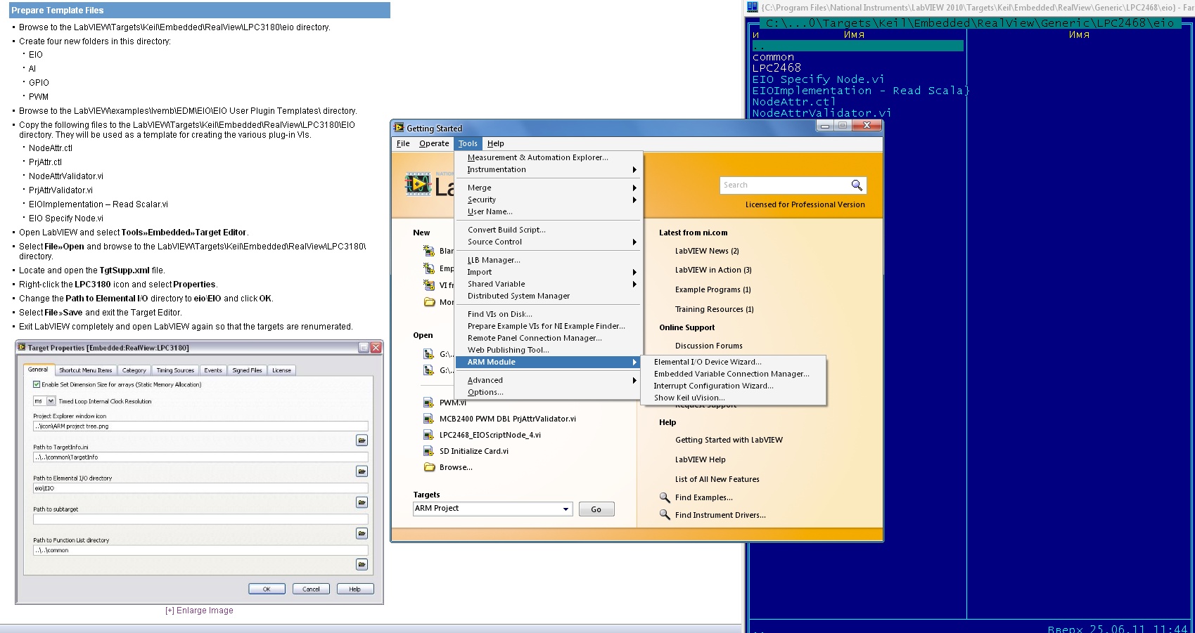

You can also try to port the pins yourself by following this link:
http://zone.ni.com/devzone/cda/tut/p/id/6994
After that youwill have to write the proper instructions in order to do a PWM. If you have any questions regarding these, let em know. Thanks,

From the steps that I gave to you in the link:
  • Browse to the LabVIEW\examples\lvemb\EIO\EIO User Plugin Templates\ directory.
  • Copy the following files to the LabVIEW\Targets\Keil\Embedded\RealView\LPC3180\EIO directory. They will be used as a template for creating the various plug-in VIs.
The files will not be there until you copy them over to that directory that you have created.
Applications Engineer

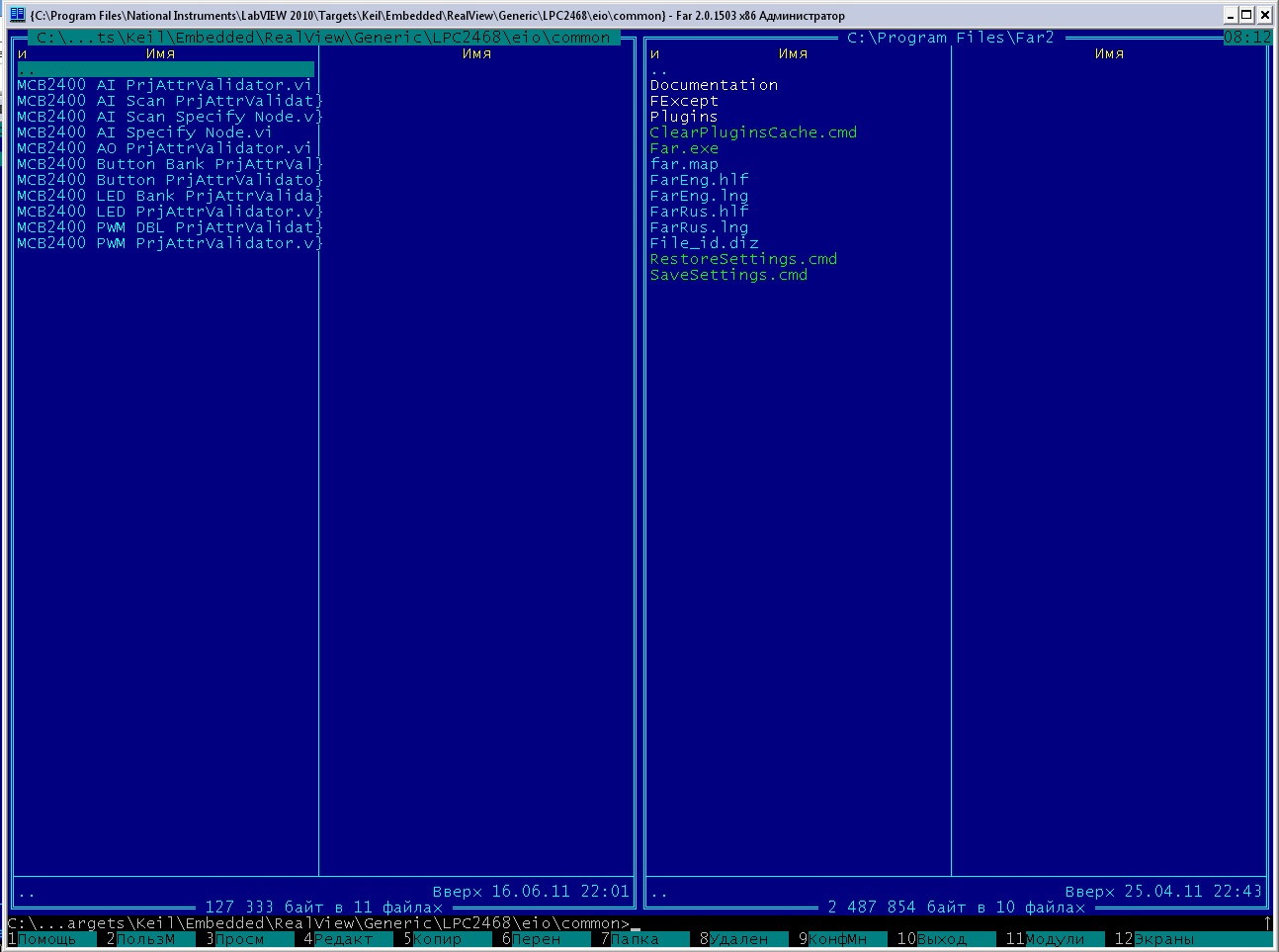

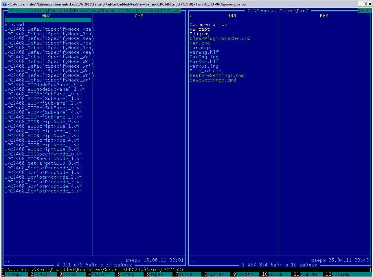

EIO User Plugin copied in 2010 ... LabVIEW \ Targets \ Keil \ Embedded \ RealView \ Generic \ LPC2468 \ eio
but then could not find: Target Editor
where is it?

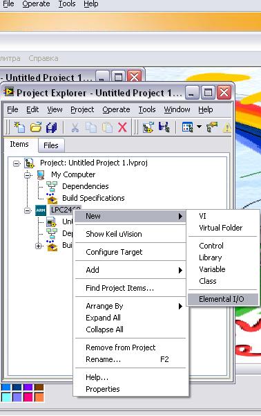

my step
where is it?
Thank you!

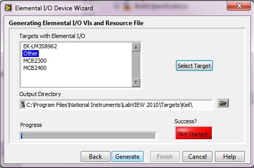

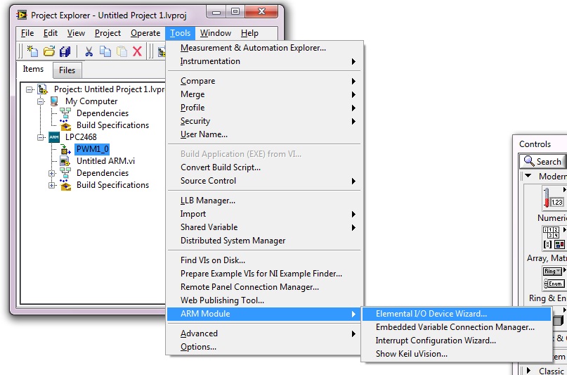

You need to use the ARM Elemental I/O wizard.
Message 9 of 22
(10,170 Views)

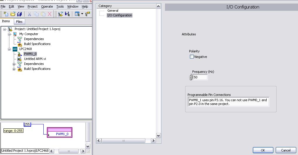

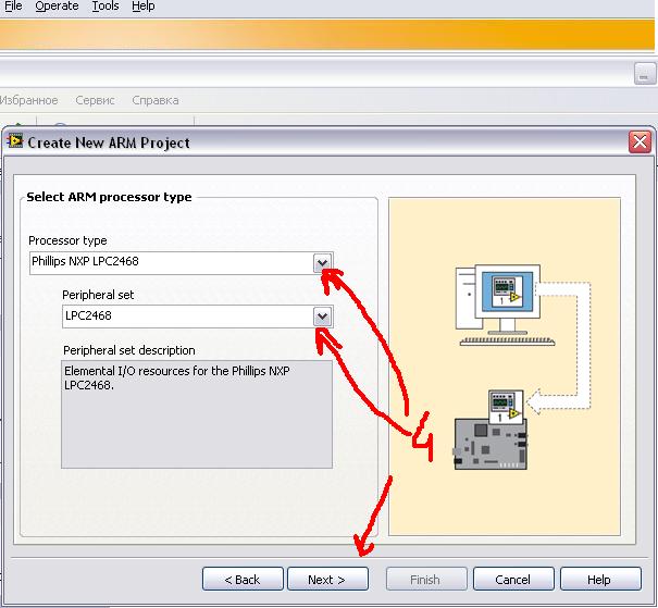

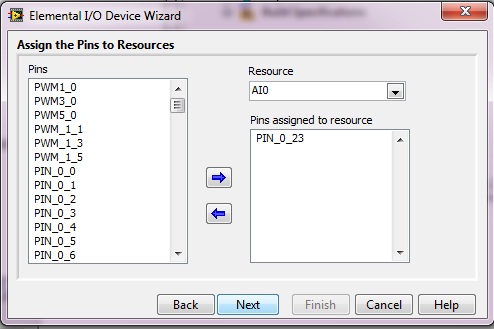

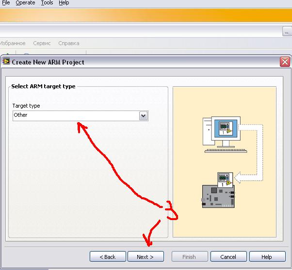

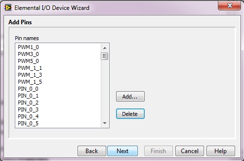

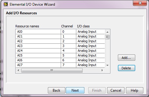

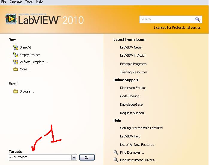

Thanks for your help!
my next steps
What next?
