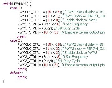

This code is suitable for LPC2468?
Message 17 of 22
(5,590 Views)
That code does look suitable for the LPC2468
