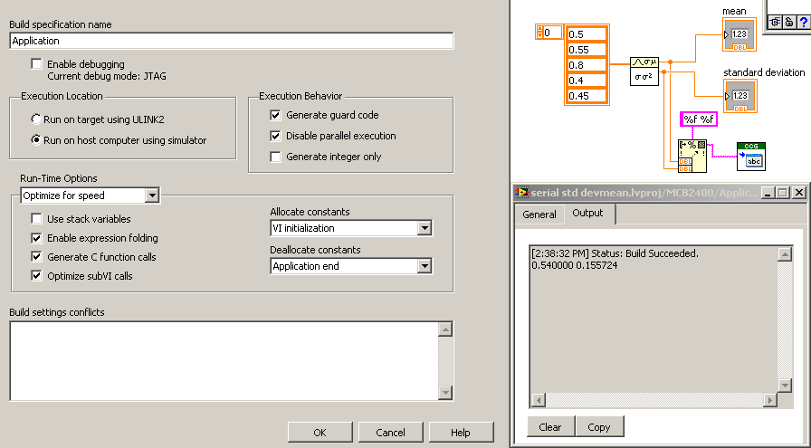

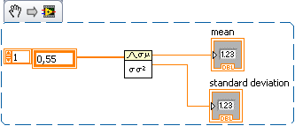

I tried now some examples, which I can post here. And I found out that it is enough to use just the standard deviation node like here:
In this case it doesn´t bring the  "LV runtime error in file CCGArrSupport2.c ", but the VI doesn´t work anymore (the outputs is 0) when I just activate "Disable parallel execution" (not the whole optimize settings, because there is no debug output anymore), which is necessary for the optimize options.
If I use the "Disable parallel execution" alone for the whole project, I get the same  "LV runtime error in file CCGArrSupport2.c " Error. So the Problem seems to be in this Option.
Same Problem if I try to profile the standard deviation. I don´t get a error, but it doesn´t work.

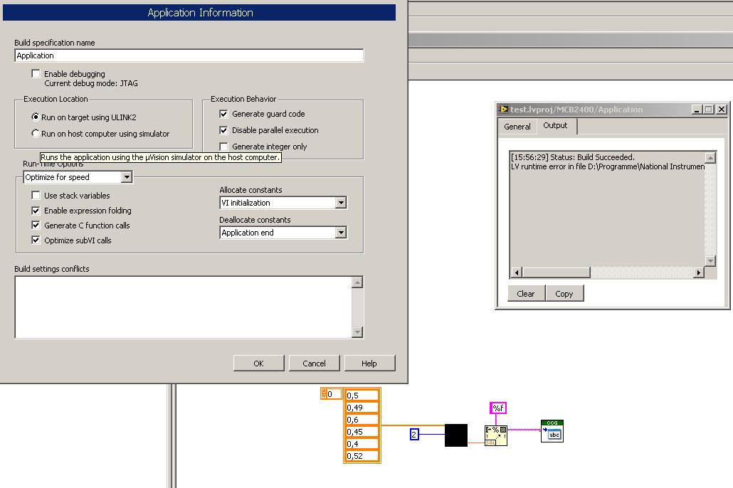

you are right. In the example it was just a Problem with the output.
Now here is one little part of the project which brings the runtime error allone, which brings the runtime error (just if the optimize option ist activated).
The Black Node is a Sub-Vi.

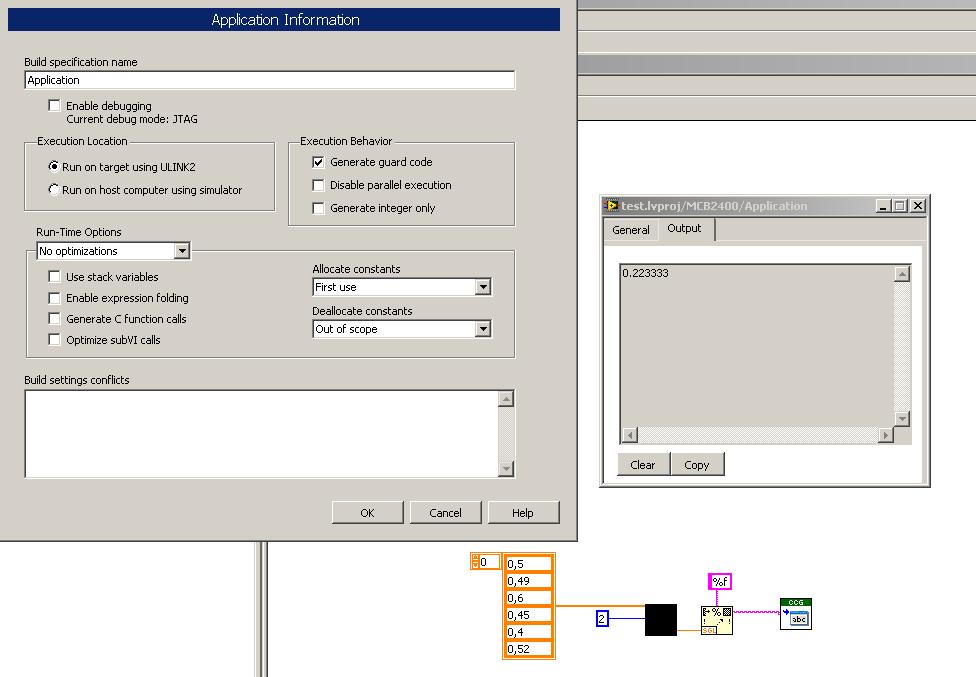

The runtime error has its roots in the constant initialization.
When choosing "Optimize for Speed" or just "Generate C function" calls for applications with subVIs that contain constant array initialization use always the option "Allocate Constants" on "First Use".
Other workarounds may apply as well: initialize everything in Top VI, use Initialize Array instead of constant arrays, etc.
(8,960 Views)
Ok thanks !
The woraround with "Allocate Constants" on "First Use" works fine.
