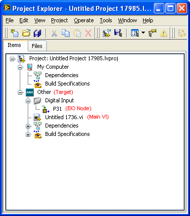

I notice the EIO node has black text.  This leads me to think you don't have the EIO node added to the same target as your VI.  (see pic below)
If that isn't the problem, then perhaps something is broken in the EIO implementation VIs.  You can try repairing your installation of LV / LV ARM (using the Control Panel -> Add / Remove Programs dialog)
