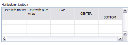

Often when using tables (and multicolumn listboxes), the content of the table column or row header is longer than the desired width of the cell.  It would be nice if there was an option to make the contents of the cell wrap to the next line, similar to how tables work in Excel or Word.
Also, adding vertical justification options such as Top, Center, Bottom to the Active Cell property subset would be nice.
Here's a crude illustration of what I'm talking about.
-Derek Roane
