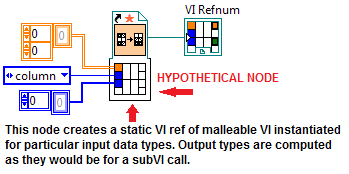

One more point: It might be possible to have a "generate specific malleable VI instance" node that is a strict VI reference that also is wired with types to fill in the types of the VI terminals. It would be a very strange and complex node, kind of like the halo that you get on a subVI node if you right click on it and choose "Enable Database", but it would handle the case you're asking for here. Fairly surreal, and something I would likely only embark on if I saw a fairly large swath of users needing the functionality.

That hypothetical node I mentioned might look something like this.
