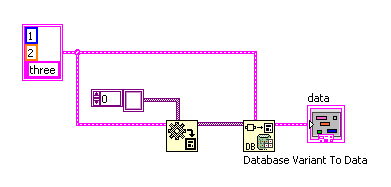

The other direction, Cluster to Array of Variants, works like this:
But trying to reverse the process breaks:
So my idea is make the second image work; make an Array of Variants interchangable with a Variant Cluster in the "Variant to Data" LabVIEW primative. The interchangability should apply to contained subclusters/arrays also. The matching of array to cluster elements can be by cluster order rather than element name.
