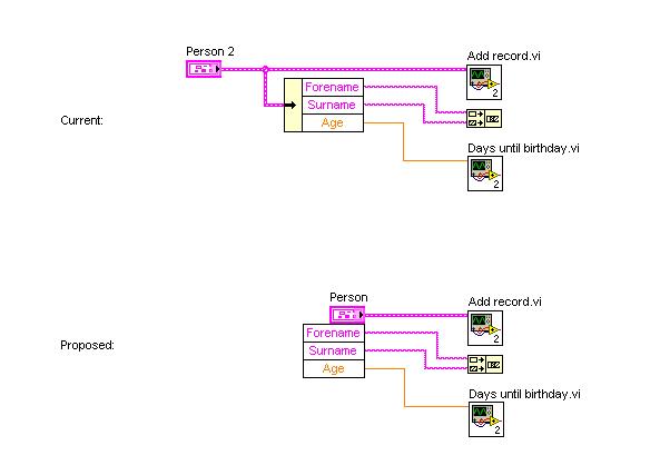

When using clusters, it's normally necessary at some stage to unbundle or bundle. The block diagram could be made cleaner if cluster terminals could be expanded by the user to show bundle and unbundle terminals, basically by incorporating the current 'unbundle' node. The diagram below illustrates this.
Additionally, this makes it much tidier when trying to modify an element in a cluster. In the picture below, the top image shows the current method and the bottom one shows the proposed method:
It might be that there's already a way to do something like this but if there is I don't know about it!

While this is a novel idea I don't think it would warrant adding it. The vast majority of the code working with clusters will have the /bundleunbundle on the block diagram without the terminal there. This would be fairly complex for NI to do since it would mean they would have to support a special terminal on the block diagram. This would act different from all other terminals.
