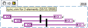

The new Sync.vim is one of my favorite new features, as it takes significantly less space on the block diagram than a flat sequence structure or other alternatives. However, whenever more than two wires need to be synchronized, additional instances of the vim must be added:sync vim 3 elements.png
I think Sync.vim would be an even better tool if the user could drag up or down to add additional terminals (like "build array," "build cluster," etc).
