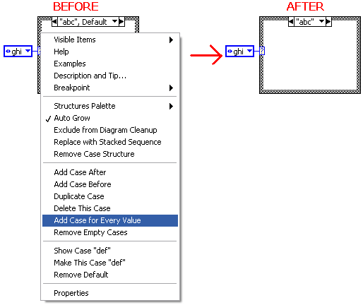

Wire a Case Structure with an enum. Now pop up on it and select "Add Case For Every Value." In today's LabVIEW, this adds new frames to the structure so that every enum value is handled by a unique frame. This makes creating the structure initially easy, and it gives you a way to walk through and make sure that you've filled in code for every frame. But today, the Case Structure has includes the "Default" case when the Case Structure is first wired. That is done so that wiring a Case Structure with an enum does not result in a broken VI. When a programmer provides a unique case for every value, the Default state is now redundant, and the only thing it does is create the potential for error if you ever add to the enum. Thus I would propose that if you use "Add Case For Every Value", then LV should remove the Default tag from the first case.
