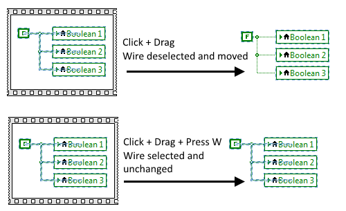

I've found even if I'm moving a self contained selection (a constant wired to some local variables) into or out of a structure, wires become deselected and then get shifted around. If I (remember to) press W, the wires remain selected and are unchanged. The wiring algorithm should at least handle this case and not apply any 'connected wire' logic.

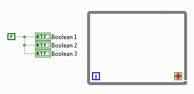

More wire maintain connected wire shenanigans (LV2017 SP1 Edit: actually LV2017, the first issue seems fixed in SP1, though still changes the wiring per my previous post):
Yeah, I didn't really need those wires anyway...
The one potentially useful use case of dragging out of a sequence structure, and it doesn't maintain the wire (W was not pressed in this example).
