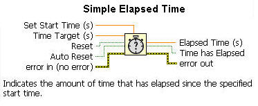

This could be in addition to the existing Express VI called Elapsed Time. This function or VI is simplified: without all the String outputs, and not an Express VI. Smiley Happy
