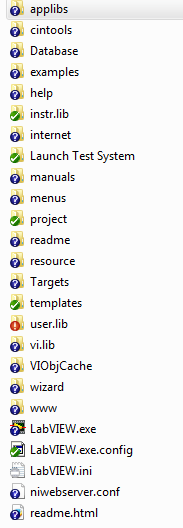

Interesting discussion.  here is my take.
Instr.llb, templates, User.llb(except _subfolders) These I HAVE source code control for. underbar subfolders e.g. _probes need some training for adoption.  Not one I'm pushing today
errors.  again any custom errors for this groups components are in SCC.  (That's what the readme file in errors is for, so we can track our "error budget")
examples.  do not go in SCC--yet  (well not here- they do in my happy place) and this is potentially MORE harmful than playing around with things in vi.llb
wizards & projects, These are often 3rd party packages I should be able to track and fix any corrupted packages with VIPM.  If I put something there I'd add it the SCC.
That leaves a lot.  Let me put 1000 words on it
Thats a lot of stuff that can go wrong (I wound up with a bad icon editor once or twice that I needed to reload from a safety copy) in a lot of places I want access to.
I would LOVE a default ini section that lets me lock down vi.llb and examples.  I have a few people in mind who need their ini hacked in just such a manner. (and one to "Prevent saving from previous" while I'm at it just to save a few hypertension pills.)
Is SOMETHING needed,  probably- but we must recognize this feature would be like "training wheels" for LabVIEW or, like the driving instructor's passanger side break pedal.  Useful to prevent costly mistakes until and unless you need to get some serious performance out of highly skilled developers.
