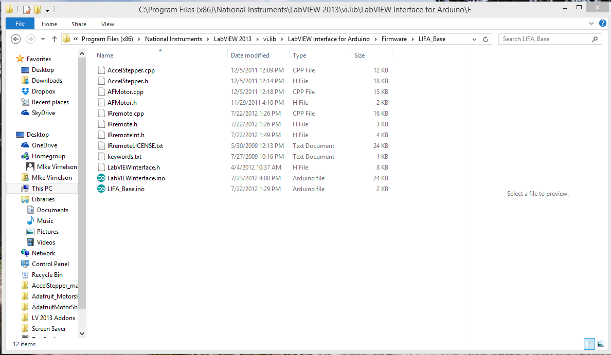

The LIFA_Base folder should contain the following 12 files.
LIFA_Base     an .ino file
LabviewInterface  an .ino file
AccelStepper   a c++ file
AFMotor     a C++ file
IRremote     a C++ file
AcelStepper   a Header file
AFMotor       a Header file
IRremote      a header file
IRremoteint  a header file
LabbviewInterface   a Header file
IRremoteLicense   a Text file
Keywords      a Test file
The LIFA_Base folder is created by the VI Package Manager and the 12 files listed above are installed in the LIFA_Base folder by the VI Package Manager.  Except for the two text files all of the files listed above are required for installing the LIFA firmware on an Arduino board.
Please compare the content of your LIFA_Base folder with the above list and let us know what is missing. .

Nathan, yes i have tried your suggestions of making sure i have the latest arduino and its not the beta,  in addition i checked to make sure i was using the open dialog and opening the correct .ino still does not complie. and hrh1818 provided me a list of what file should be in the folder, and they are.  i feel my .ino code might have gotten modified somehow.  However you had both suggested earlier to upgrade to the LINX.  I downloaded that and my question is should i just use that instead of the LIFA or does that still need to be addressed first?

Do not reinstall the LIFA firmware files on your PC.  The screen shot you provided shows you have a good installation of the LIFA firmware files on your PC.  However the screen shot and the trouble you are having suggest you are using the wrong method to access the LIFA files when compiling the firmware.  Try either of the following two methods and report your results.
Method 1.
In the Arduino IDE in the menu bar click on File and select Open.
Select Local Disk C
Double click on Program Files
Double click on National Instruments
Double click on Labview 2013
Double click on Vi.Lib
Double click on Labview Interface for Arduino
Double click on Firmware
Double click on LIFA_Base
Select LIFA_Base.ino
Click on Open
Compile the code
Second Method
Use Windows Explorer to navigate to the LIFA_Base.ino file and double click on the LIFA_Base.ino file.
This opens the LIFA_Base file in the Arduino IDE.
Compile the code
The explanation for the two above methods is the Arduino IDE needs to know the path to the LIFA_Base file so it can access all of the external files referenced by the LIFA_Base file.
You have had two separate problems. Getting the LIFA_Base file to compile does not fix the problem of using the version 2 Arduino Motor Shield with Labview.   But getting the LIA_Base file to compile means the operation of LIFA is consistent with the original developers intent.
