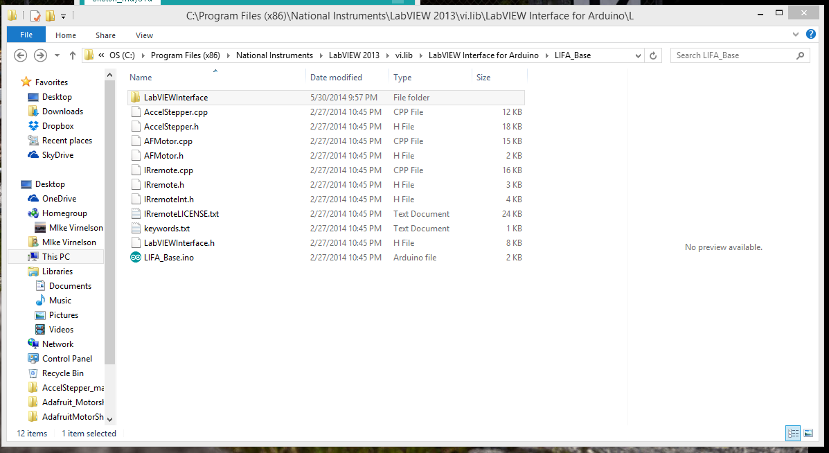

Your Arduino IDE is not properly opening all required files.  It is missing LabVIEWInterface.ino.  This is why it won't compile.  Also, make sure you are not using the beta version of the Arduino IDE.  Use version 1.0.5.

You aid this was the path to the LIFA version that did not compile.
C:\Program Files (x86)\National Instruments\LabVIEW 2013\vi.lib\LabVIEW Interface for Arduino\LIFA_B...
This path looks very suspicious.  There should be a Firmware folder  after "Labview Interface for Arduino" and before LIFA_Base in the path.
Try this path to see if the LIFA firmware complies.
C:\Program Files (x86)\National Instruments\LabVIEW 2013\vi.lib\LabVIEW Interface for Arduino\Firmware\LIFA_Base

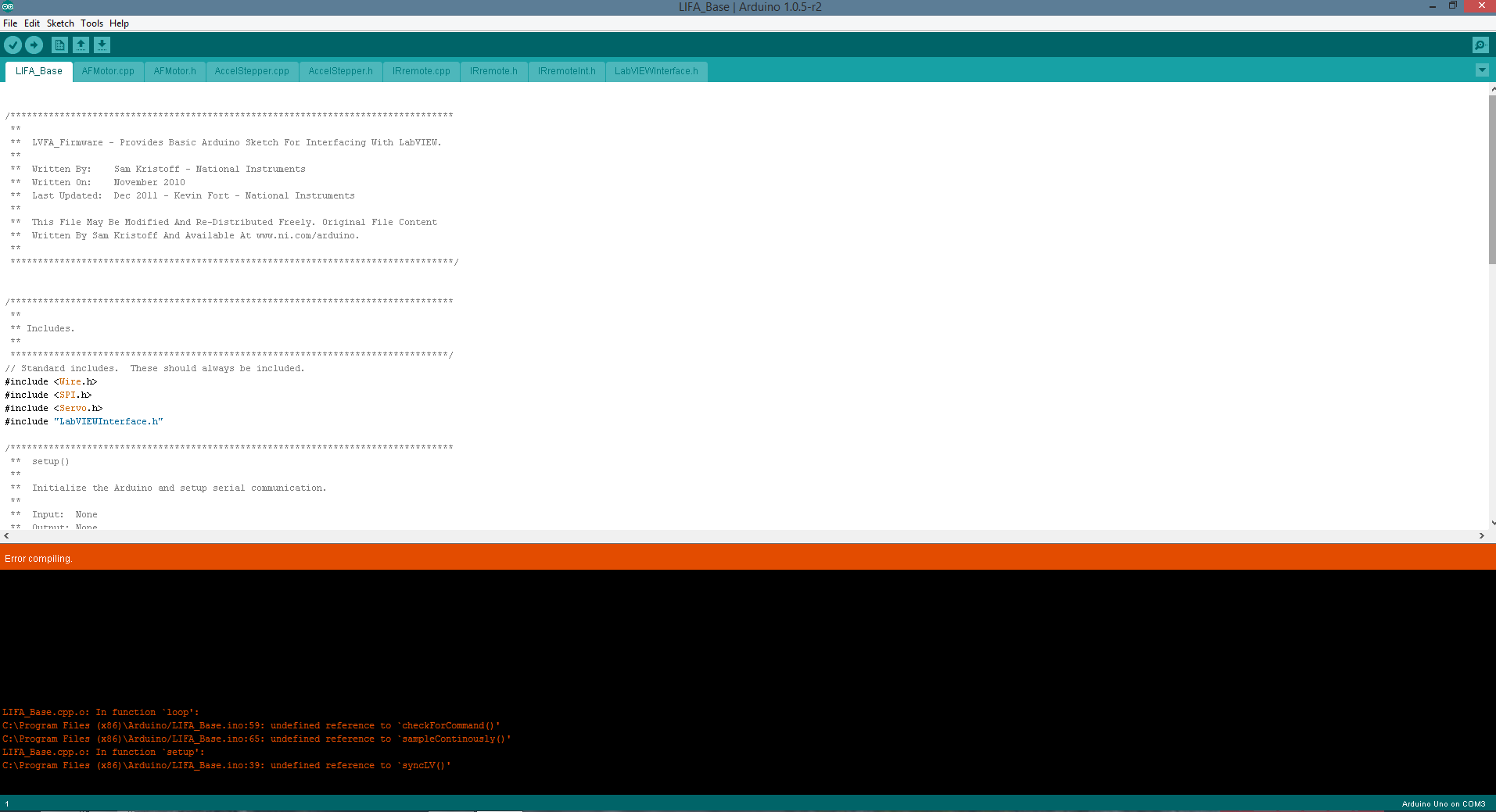

ok i uninstalled the labview interface and reinstalled it to ensure i have the latest one and i will post the errors in complining.  And in response to earlier, yes you are were right it was in the ...LabVIEW Interface for Arduino/firmware/LIFA_Base and still get errors.  theres a ton of errors this time.  maybe i should uninstall some of these things and reinstall because it seems there are files that are not in their correct locations.  What should i uninstall?  the Arduino exe?
