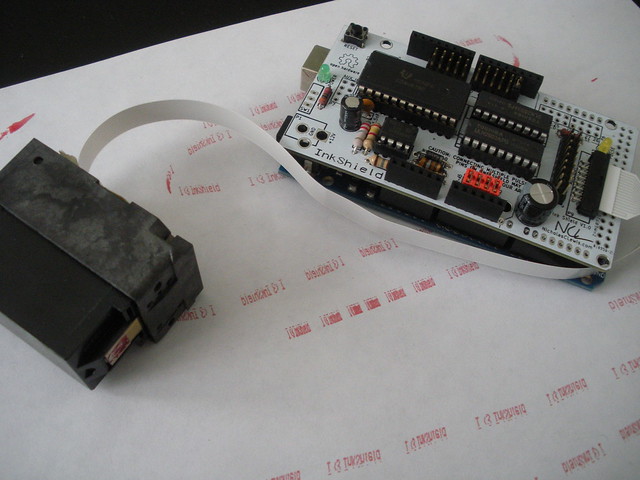

I would like to try to use an inkshield with LIFA so I can drive an inkjet printhead with labview.
DSCN7348
According the theory page of the inkshield the timing is very important to drive the jets correctly.
I would like to make a new subvi that tells the arduino to execute these lines of code:
PORTB = PORTB & 01111111;
delayMicroseconds(5);
PORTB |= 10000000;
delayMicroseconds(800);
This will be my biggest project so far so any suggestions would be very helpful.

Do you have this code working in an Arduino sketch already?
Making custom functions for LIFA is quite simple.  Start with duplicating an existing function from LIFA and make sure that you have this custom one working (new code on both the Arduino and in LabVIEW).  Then, start customizing by adding your custom code to the newly created LIFA function.
Message 2 of 8
(6,429 Views)
You were right! That was incredibly easy. I just copied a few lines of code from the inkshield example sketch into lifa_base.ino and renamed it lifa_ink.ino. I then edited some of the lifa examples. If anyone is interested you can see the attached code. My example indexes a stepper motor and then fires any or all of the 12 inkjets availabe.
