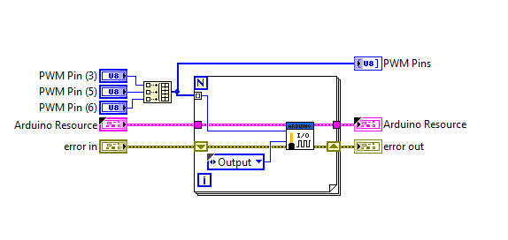

Hi Hooman,
The best way to set your digital channels is to use a for loop to set the pins one by one. Due to the fact that the ATMega is a single-core CPU, it can only due one thing at a time. As such, you cannot set all the digital channels at exactly the same time. See the screenshot below to see how to set multiple pins. This is taken from the PWM Configure Port VI.
Hope this helps,
- Julianne
