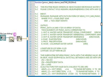

I having a binary coded file, and Matlab code also, but i am not able to open that file , so I want to open and run that file according Matlab code. here is image what i want to do, and also attached here input file and matlab code.

Your script reads data from .dat file and formats it into 3D array. Unfortunately, MathScript currently can not handle 3D array.
By the way, you can use the following code to read the data in LabVIEW.

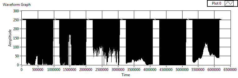

I do not see any problem to read the data from new attached input file. The following figure shows the data in Waveform Graph.
