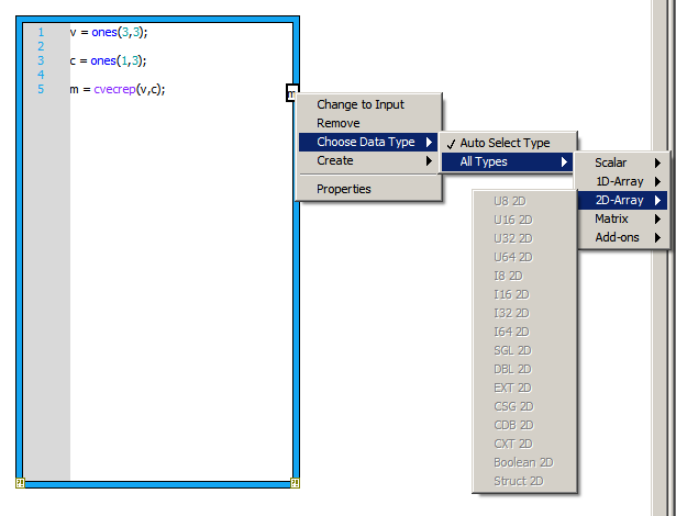

Martin, HI!
I already know that the data type must be set if LabView doesn't detect it itself.
The problem is, that LabView sets the output variable to type void (black color) which makes it impossible to change it's type (every type is greyed out). This happens even with the simplest, one line function, as cvecrep(v,c) (attached with previous post).
Whe I try to call this function from a MathScript node, in which i define the inputs as such, for example:
v = ones(3,3);
c = ones(1,3);
and then call
m = cvecrep(v,c);
The function cvecrep is on the path, that is set both in the VI and in the MathScript Window.
For reference i have attache an image:
This behaviour makes the use of MS node outputs useless, since i cannot connect them further, because they have no data type.
If I use the function contents - the one line, within the node, the data type is set normally.
Hope this explains the problem more thoroughly.
Cheers, Luka

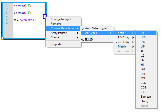

Hi LukaAmbrozic,
in the attached image you can see that type detection works for me. I have LabVIEW 2012. I think that you have to run the VI first without outputs (LabVIEW be able to recognize the data types) and after that adding the output should work fine.
Regarding to the path() function, it should have the same functionality as the configuration dialog you talked about. I run the code with path() function only once (just for adding the folder) and then I changed it to comment using % symbol.
