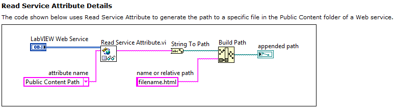

I also came across this, which was actually giving me error, may be because I am not doing it the right way?., but gives some hope.
