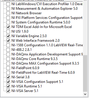

          I had created a webservice for my application and i put to serve a index.html when user accessing the webservice. In my development laptop, i deployed and i managed to access my webservice using localhost:8080\webservice . When i build an installer with my application and webservice and installed it on another new computer, i cannot access the index.html by default. I need to type localhost:8080\webservice\index.html. In webservice build setting, serve default index.html for static document folders is checked. The file index.html also inside the webservice folder of C:\ProgramData. My application still working in the new computer , just i need to type localhost:8080\webservice\index.html instead of localhost:8080\webservice. I am wondering why i cannot access the webservice index.html by default in my new computer. Maybe i missed include some additional installer? Here i attached all the addtional installer that i included in my application installer.
