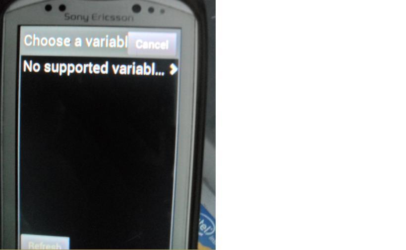

I am working with Data Dashboard for Android, on a Sony mobile, and I have followed all the procedure to create, build and deploy a web service.
I am able to access the Web Server from the Data Dashboard application, and  I can also visualize the Web Services and their deployed variables.
The problem comes when I select a particular deployed variable; I am shown a message " no supported variable...", when I select this, i am taken back to the home page of  Data Dashboard. Below is the picture of the message that I am getting.
I verified the data types of the network variables I used in my VI, and they are all supported by Data Dashboard.
Anyone has an idea on what's actually happening, and the reason of this message??

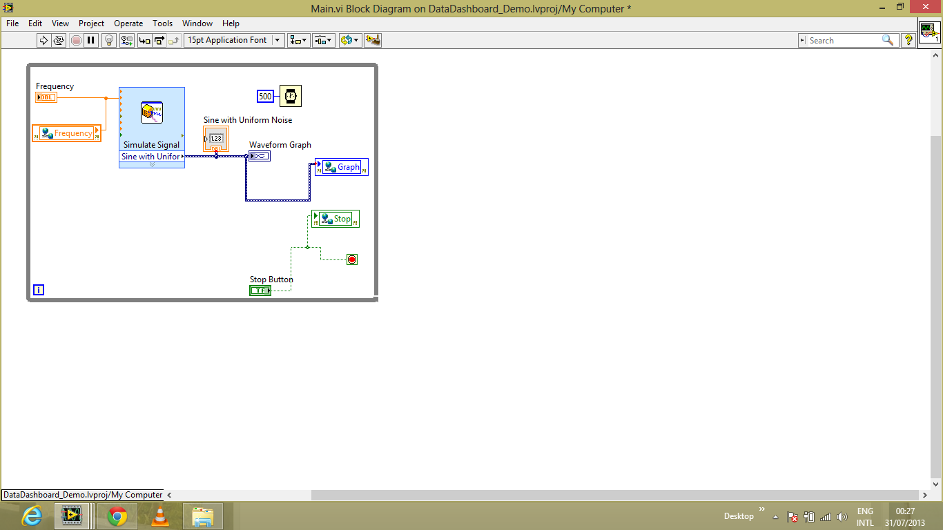

I used the Code example given in the NI tutorial; and in the video illustration by the NI engineer, the code worked properly.
Below is the picture of the main block diagram.

It looks like your variables are arrays of doubles. The version of Data Dashboard you are using (1.0 for Android) does not support arrays. It only supports scalars and strings. This document lists the supported types: http://digital.ni.com/public.nsf/allkb/D9B247551BE7F46A8625795000552CDE
If you change the arrays to scalars then you should be able to use a numeric, gauge, or chart indicator to display your data. You won't be able to do anything other than display your stop variable, though. Data Dashboard 1.0 does not support modifying values. For that you need 2.0, which is currently only available for iPad.

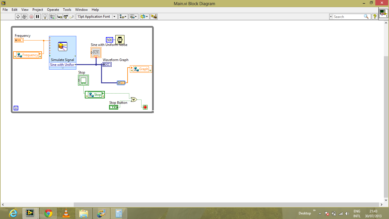

here is the code that I tried.. you can see that compared to the previous code I converted the Stop variable into an indicator, and the Graph variable is no longer an array but Int16. Still the same "No sopported variable is coming".

A screenshot isn't really good enough to see if you are doing something subtly wrong. Please attach a zip file with the project you are using as well as the library containing your shared variables and your .vi file. Then we can actually test your exact code to see if we can reproduce the issue you are having. That will help us narrow it down.
