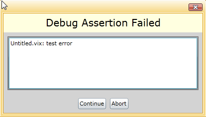

You can create error windows using the Display Debug Assert function (http://zone.ni.com/reference/en-XX/help/373286A-01/uibuilderref/wuib_display_debug/😞
Note that I have to invert the error boolean to make the dialog pop-up.
