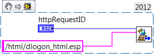

I think I have misunderstood one thing. First, I created a static .http document to be the first page, this was called directly and then called a web method (.vi), and so on. This worked fine. But when I added ESP code to that document, nothing worked.
Now I have added a tiny web method, only with the code below, using streaming output type, and then it works fine.
Does this mean, that to use ESP I have to make a web method - I cannot simply embed the ESP code in a static .html file ?

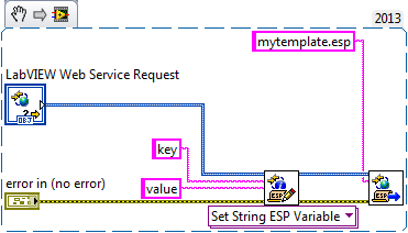

The URL for such an web method may be something like /MyWebService/Hellovar/Jan where Jan string literal passed to the terminal of a web method that may look something like
In this example the string "Jan" is passed to the value terminal of the VI.  When setting up the Web method in the build spec its signature would look something like /Hellovar/:value.
So to go back to your original questions.  You do not embed ESP within and HTML document.  Instead you embed HTML inside an ESP document and the docuement is rendered as HTML when the URL of the Web method is accessed.  The While paper you cited previously has an example project within it that you can use as a reference
