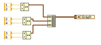

how can I make XY Graph with LV Web UI builder ?

In the cluster palette, you will find a Bundle Point function.
Use it to create the Point datatype.
Use Build Array to create an array of points.
Wire the array of points to the graph terminal.

Hi witwit65,
To create an XY Graph in LV Web UI Builder you will use a normal Graph from the palette.  To create the XY data use the Bundle Point function in the Cluster palette to wire in your X and Y data for each point.  Then build an array from those points.  When wired to a graph, the graph will become an XY Graph.  It will look like this:

In the Web UI builder, this doesn't seem to work. I use the bundle point function as shown, but when I add the "Build Array" function, the program won't run without two inputs (the input from the build point works). It seems in this example that you have only one input in the build array function. Any help would be appreciated

Could you post a screenshot of the code that isn't working for you?
Jared's example above shows one way to use an XY Graph in UI Builder. That example does not use Build Array - each iteration of the For Loop computes one point, which are combined into an array of points with the auto indexing tunnel.
You might use Build Array if you have multiple literal / constant points that you want to combine into one single point array, like the following:
