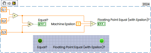

There is of course the (build in) "floating point compare" function, that we are recommended not to use for undisclosed reasons, although it does exactly what you're looking for:

How can I use this function? Can you please attach a VI file that I can open?
Something like this:
