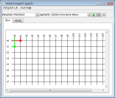

Wanted to work on a different project and after installing the newest versions of the drivers this is what I have.
I'm not positive it's Kanji but it doesn't seem to be English. Uninstalled and reinstalled the drivers with the same results.

NI-DMM 3.0.4 includes the following bug fixes:
  • Fix related to code not generating in the Japanese versions of LabVIEW when the NI-DMM/Switch Express VI was used with switch devices (ID 276993).
Guess they fixed it too wellSmiley Very HappySmiley Surprised

This morning I uninstalled everything dealing with LabView and installed 2011 from the DVD's. Cleared up the problem with the text but I still have the memory error problem.
