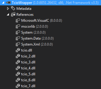

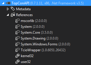

You didn't mention LabVIEW bitness so I assume you are running LV 2014 32-bit and are using the x86 versions of the dlls. I downloaded the API and has builds for x86 and x64; you should use the version that matches your LV bitness.
.NET Framework 3.5 contains .NET 2.0; so you don't need to worry about installing that. My inspection of the dll itself shows that it is compatible with 3.5. However it also showed that it has dependencies on other dlls; directly to "TcioWrapper.dll" and then indirectly through that to the other named "tcio_x.dll" dlls. All of these should be present in the same folder as your exe (or the data folder that is created when you build); alternatively you could install them to the appropriate system folder that hosts 32-bit libraries (note that its SysWOW64 on Windows x64 that hosts the Windows-on-Windows64 layer for 32-bit applications to run on a 64-bit OS).
Dependency on "TcioWrapper.dll"Dependency on "TcioWrapper.dll"
Dependencies on other "tcio_x.dll" Win32 librariesDependencies on other "tcio_x.dll" Win32 libraries

tyk007, thank-you so much for your detailed suggestions 🙂 🙂
Yes, I'm running the x86 Dlls on X32 Labview on W7 X64,
I checked in ILSPy, TopCon API has  Architecture: 32-bit
TCIOWrapper has : Architecture: AnyCPU (64-bit preferred)
ILSpy can't decompile TCIO, TCIO_x.DLL "This file does not contain a managed assembly" which I think is because they're C DLLs which are nearly impossible to decompile so we have to assume they are indeed x86 compatible.
