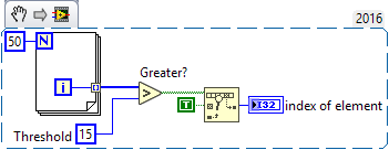

You could use "Greater?" to see when your array exceeds the threshold. Then use "Search 1D Array" to get the index of the first value which crosses the threshold, like this:

I am following you for th most part, but how / where do I connect my array data?

You would replace the for loop with your data, so instead of the for loop you would have something like:
