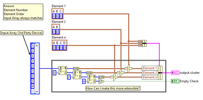

I'm looking to turn a long array of u8 received from a 3rd party application into a cluster of status elements (cluster of clusters)
I don't like how I'm repeating the split 1d array and array to cluster conversion. Although this works for 3 elements, I wouldn't want to do it for 20. Can I set up the conversion in a more extensible way?

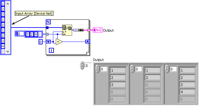

the conversion can be made much simpler:
When you want to repeat a process step you should use a loop!
So place the conversion into a (while) loop and repeat until the remaining array is empty (or smaller then needs to be). You can also use a FOR loop when you calculate the number of conversions from array size…

Well, the problem is that you can't really use a loop efficiently, because clusters are fixed in size and you cannot e.g. have an array  where each element is a cluster with a different number of elements.
Maybe you want to re-think your data structures. For example you could have an output array where each element is a cluster of an array. Now each element can be of different size.

To steal from altenbach, you can do this with post-card sized code.  You just need the Byte Array To String followed by the Unflatten From String.
