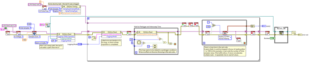

A colleague recently gave me some code to look over since they were running into an error using DAQmx Logging: "Error -201311 occurred at DAQmx Start Task.vi", "File specified is already opened for output. NI-DAQmx requires exclusive write access."
Searching tells me one cause for this error is that multiple tasks are trying to use the DAQmx Logging functionality, but I'm pretty sure that only the one task ever makes any reference to DAQmx Logging. I've removed local variables and superfluous indicators, and so I now don't think there's anywhere else that has access to the DAQmx Tasks to change these settings.
I've refactored quite a bit of this section of the code, and now I have it down to a state machine that gets upset when it calls the "Logging.TDMS.GroupName" node (in a loop). It errors on the second attempt to log data (the first time it tries to change the group name after logging).
I can't see the functional difference between my colleague's (with my modifications) code, and the following, but this code works as expected, so there's obviously something.
Is there anything I should be particularly careful of/aware of when using the GroupName property like this?
Here I am switching the "Read and Log" and "Off" values, but now in the real code it will instead use "Off" until a button is pressed, then go to "Read and Log", then return to "Off" after the N iterations (so changes occur whilst the setting is "Read and Log", but the task is Stopped).
I tried setting it to "Off" after each iteration before calling the GroupName property, but it didn't seem to make a difference.
As I understand the documentation, this property change (Mode) takes effect only on the next read, so if it is turned off, then on, then DAQmx Read is called, it should be the same as if it was never changed?

Bahh... I was assuming the problem was my snippet was too new a version, but I now see, no snippet.
Here's the VI, backsaved to 2016. The real code is running in 2016 64-bit, but I've been testing using 2019 32-bit and an NI-MAX provided simulated PXIe-6358 in "PXI1Slot2".
I'll see about posting some of the actual code, but since it was given to me by someone who was given it by someone who was given it from some other institutions, blah blah blah, I can imagine this might not work out.

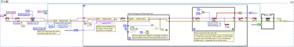

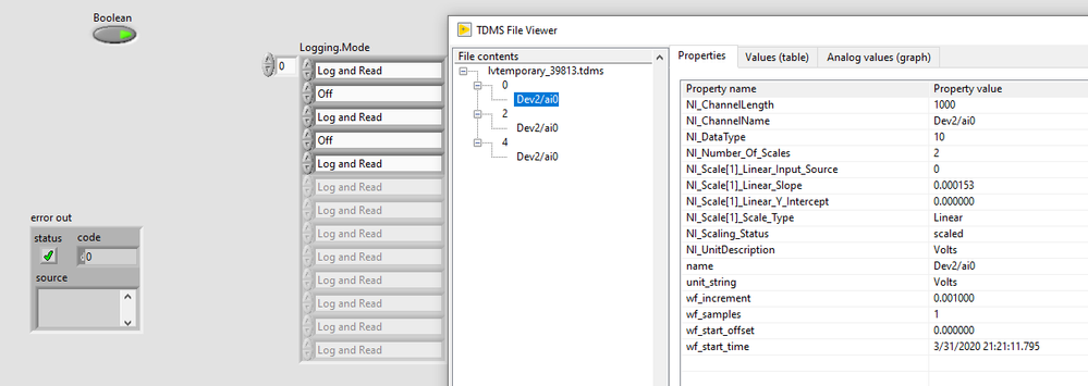

Thanks for posting. Just ran this on LabVIEW 2019 64bit with a simulated device. I deleted the counter task, no idea if that has any effect. See below.
This worked for me without errors. See below.
The code seems to work. I am a loss as to what the problem is. Sorry.
