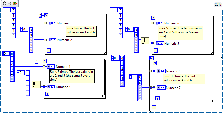

You should additionally be aware you have 3 different end conditions for your For loop, which I would bet almost anything isn't what you want.
The loop will stop whenever any of them is finished - in this case, it will iterate once for the value from the binary1.csv file, with only one value in the array.
You want to get rid of the constant 10, and if you know that the value you want to match is always one value, just make that value NOT auto-indexing. If you want to compare two lists of numbers and find matches, and you're ok with a brute force approach, use two nested For loops with one array autoindexed for each. This will lead to NxM iterations in total, where N and M are the number of elements of each list.

You are reshaping the 1D arrays to 1D arrays with 1 element each, so your FOR loop will only execute once (no matter what you wire to N). Also, if your FOR loop would execute 10 times, it would be so fast that all you see is the result of the last iteration.  You have not attached the csv files, so we cannot really tell how they are formatted, but as others have said, you are probably not reading them right.
All you probably need is get the single value from one file as a scalar, and the array of values from the other, compare them with "equal", followed by "OR array elements" from the boolean palette to get the result.
