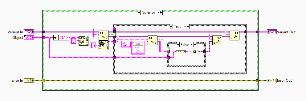

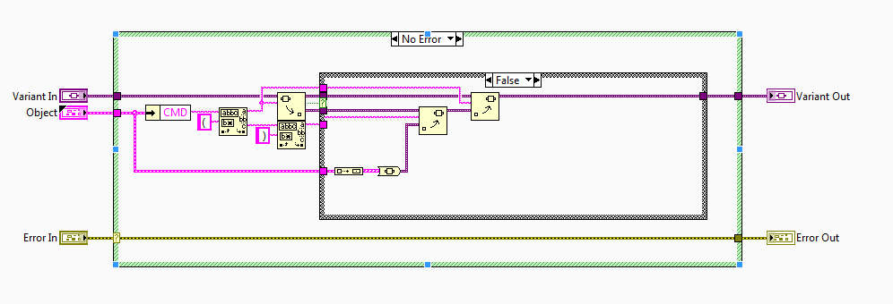

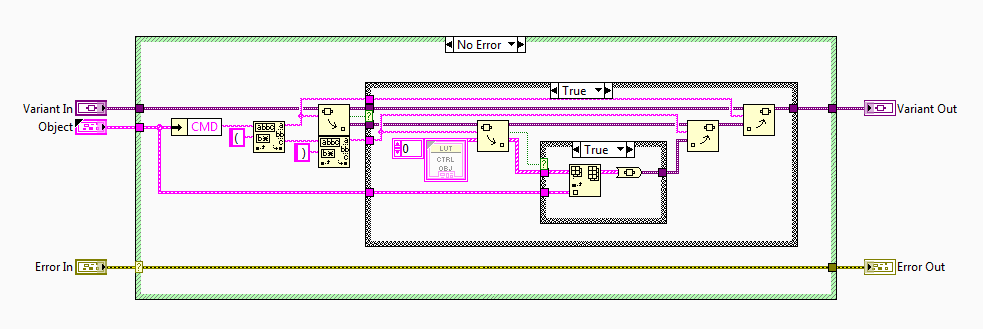

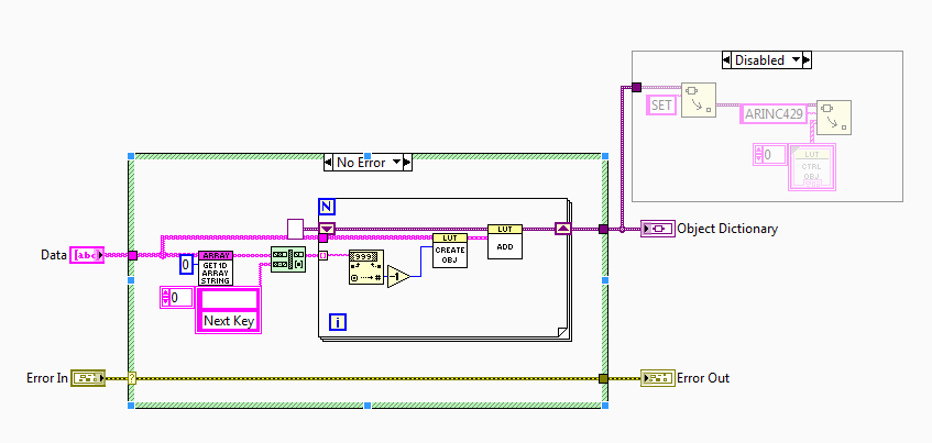

I recently implemented a 2 Level Object Dictionary for LabVIEW and will share the code (screenshots only) as none is available online.
Screenshots:
Object Dictionary 2 Levels Add Entry to Existing L1 and Existing L2
Object Dictionary 2 Levels Add Entry to Existing L1 and Non-Existing L2
Object Dictionary 2 Levels Add Entry to Non-Existing L1 and Non-Existing L2
Object Dictionary 2 Levels Create OD (Example of implementation)
