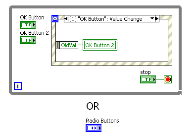

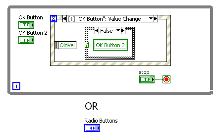

(5,372 Views)
Well, here is the simplest code around I came up with.  Another one involved using Disabled property nodes.  The way i'm posting is better because you get feedback that you clicked the button.
Message Edited by elset191 on 11-04-2009 09:15 AM

Hello Tim,
that is exactly what i need. Thank u very very much!
have a nice evening,
tom

Although I coded up what you had asked for, I still suggest using Radio buttons instead.  There is no code needed for these.
Tim Elsey
Certified LabVIEW Architect
