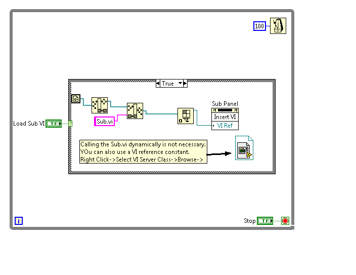

Oh I feel so stubit
I really don’t know what you mean. I’m new an trying to learn.
So if the weight in 1 instance of subvi shows 1655 g, how to get this value shown in an indicator in front panel of the top level?
Using subpanel as shown below will not distinguish between the different instances of the subvi - will it ?
Message 9 of 18
(7,662 Views)
