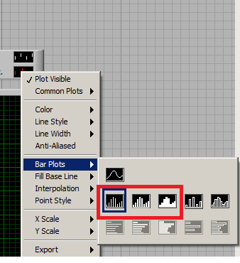

Hello, i have a problem. I need to plot 2 plots on 1 to compare their FFT. I want to have 2 plots with the same styles as u can see at plots named FFT2 and FFT3, but when i compare them at plot FFT one of them have different line style. Can someone take a look on it?

Can u tell me why i cant change width of my bars for that plot style which i use in example i sent u?? I want to have one plot a bit narrower or wider than second. I cannot change bar width only for that plot style 😕 but i really need to use that style.
Message 7 of 11
(4,963 Views)
Sure you can. You just have to tell it which plot you want to have which bar style.
Unfortunately, there are only 3 bar styles available: 1 pixel wide, "mostly" filling the available space, and totally filling the available space.

That is the problem. I wanna get a plot a bit more wider than 1 px, maybe 3-5px, but other options are: mostly filling the available space and totally filling ;//, as u can see at my pic.
Message 9 of 11
(4,956 Views)
Unless you write your own bar-plot program (which is a real PITA, I had to do it in Excel once for a publication, before LV came along, it shouldn't be hard in terms of fraction-of-the-index-values, but in terms of absolute pixels, I'm stumped), I think you're stuck with those three options. I've thought about suggesting a variable-width bar plot to NI, but haven't been able to clear enough time to write the suggestion rigorously enough to be useful. Maybe soon.
