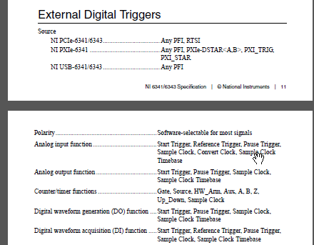

There was a similar post that involved a USB-6229 that concluded the device did not support analog triggering but I looked at the spec for the 6343 and under Analog input function it lists Start Trigger.

The 6343 doesn't support analog triggering (page 2 of the specifications).
The section you're referring to is under the External Digital Triggers section (although it is confusing due to the section being split across 2 pages):
What the document presumably intends to say is that an external digital trigger may be used as the start trigger for an analog input task.  If you need analog triggering, you should look at the 635x or 636x.
