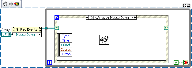

In upgrading to LV2012, I have discoverd what may be a bug, or at least an incompatability between 2011 and 2012 with respect dynamic event registration of an array of controls as opposed to individual control references.
This bit of code worked in 2011 but doesn't in 2012, with error 1 generated at the reg events block when run in 2012. I have been in contact with technical support, but haven't yet heard their take on this.
Any thoughts.

Top Application.png Here is the main program. (This snippet isn't quite right, but it somehow saved it like this... The controls are Numeric and Numeric 2, with digital references tied into the array rather than front panel reference elements.
And here is the subVI.
Any thoughts on what's going on would be much appreciated.

The latest on this issue is that NI Technical Support has acknowledged this bug. They plan to "file a corrective action request (CAR) to inform R&D and fix this error for future releases."
They also recommend to "work around the problem by avoiding arrays or trigger events using single elements."
Hope this helps others....

I have the same problem in my applications, after upgrading to 2012.
One workaround it to put the event registation in the main vi. In this case an array of references is accepted again.
You can leave the event case in the subvi, but you need to replace the "array of refences" by a event registration refnum).
Message 6 of 10
(11,774 Views)
I've got the bug too -- it appears this bug is present when arrays of control refs are connected to the ConPane. Link to cross-post on LAVA about the original problem. As Patrick@Vision mentions above, one workaround is to ensure that the array of control refs is no longer on the ConPane by collapsing the Register for Events node onto the caller.

Thanks, REDS -- with luck we'll see this in LV2012 SP1. 🙂 In the meantime, a simple workaround exists by inserting an Always Copy node just before the Event Registration node, shown here on LAVA.

CAR 366331 was reported to R&D and is fixed in LabVIEW 2012 SP1 which released today. You can download the evaluation of LabVIEW 2012 SP1. LabVIEW 2012 SP1 will also be released by NI Update Service on Monday.
