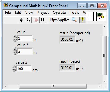

You didn't give an example, but I have deifinitely seen an issue in a basic test.
Addition seems to work fine.  But, multiplication is not.  I did a simple test.  The VI is attached.
I did three distance measurements and multiplied them together to get a volume measurement.  I did this using compound and basic multiply elements.
In LV2011, everything works as expected.
But in 2012, the VI is broken.  To get it to not be broken, I had to change the output from in^3 to in^4.  On top of that, the result is wrong.  Basic multiply elements works fine.
So, it looks like your only workaround is to either insert Convert Unit primitives or to use the basic math primitives.
Message 4 of 24
(7,375 Views)
Looking at it further, it appears in my example an extra 100 cm is being multiplied, which explains the difference in result and units.  100 cm is approx. 39.3701 in. which is the factor difference in the 122047 and 3100.01 results.  If I change my inputs, I am still off my the same factor.
If I change my units to grams, I see an extra 1000g being multiplied.
It appears that whatever the NI default unit is for a particular physical attribute, they are multiplying the result by an additional 1 unit.  So, 1m, 1kg, etc.
It may be this bug exists for non-unit multiplication as well, but when you are multiplying by 1 without units, you will still get the right result.

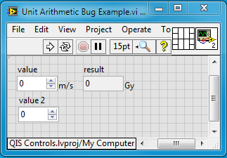

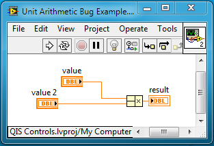

Ok, this is getting ridiculous.
Scrubbing old code for this bug I came across this:
A simple velocity multiplied by a unitless number yields units of... Gy?  I had to check what a Gy even was!  Somehow velocity = radiation??  That is just sad NI.
