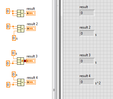

Today I realized my code broke as well due to the multiplication error when using units.
Funny fact is that it depends on the order and in particular on the first element of the multiplication. Thus it takes the product of units multiplied to the unit of the first element of the product.
See attached image:

This specific bug appears to have been fixed in the 2012f3 patch (actually the f2 patch, but it was removed due its own bug):
http://digital.ni.com/public.nsf/allkb/2F8112CC78A524FC86257A93006EA241
http://digital.ni.com/public.nsf/allkb/72A03F5B8E074C4086257A790051AE7F
With the f3 patch installed, my demo VI from this thread works properly now.
Message 23 of 24
(1,397 Views)
CAR 368375 was fixed in the LabVIEW 2012 f3 patch and is also included in the fixes in LabVIEW 2012 SP1 which released today. You can download the evaluation of LabVIEW 2012 SP1. LabVIEW 2012 SP1 will also be released by NI Update Service on Monday.
